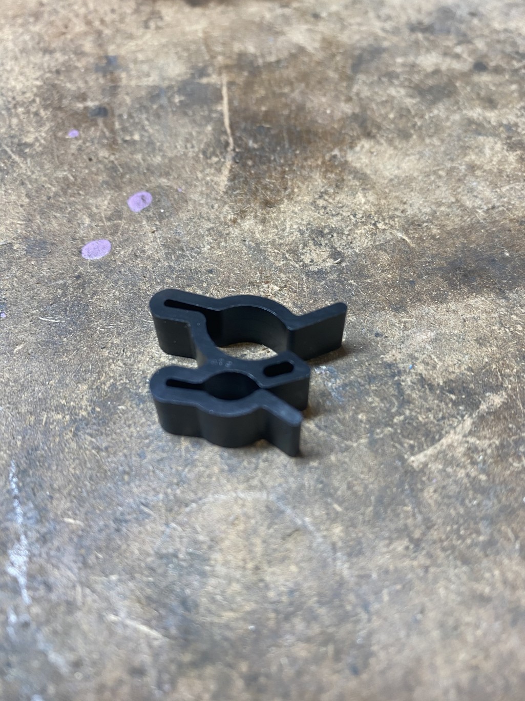

Thanks for all this information through the chat, I've ordered the parts and been surprised at how easy it is to install (since you have all done the hard work of figuring what sort of spacers and sized bolts are required :047:).  I have one remaining part from the list on your invoice (34 31 7 707 371) which appears to be a clip of some sort, I can't for the life of me figure out where this is supposed to go?  Is it for tidying the power cable in some way?

Cable clip, you need to remove the existing cable ties otherwise there's not enough length to reach round the larger locking mount. Use this to secure cable to the mounting bar.

That’s about how much my set of things came to. Thanks for the point on the clip, that makes perfect sense now that you say it.
