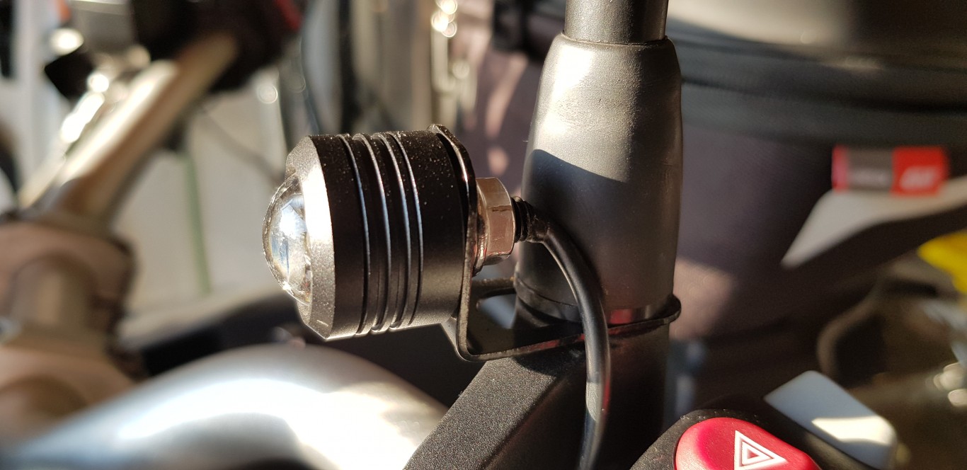

Thought I'd share my auxiliary lighting solution, not professional in any way but clean and simple.
I came from a GS and always considered the principle of 'illumination triangle' to be a very effective way of increasing road presence but never really liked the idea of large spots on my XR - no disrespect to anyone, just personal taste.
So, I found some really small 3W LED spots designed to mount on the mirror fixings. They are about 20mm diameter and incredibly bright. Rather than permanent wiring I used an old DIN socket & lead taken from an old charger and wired them directly to the power socket. Quick, safe and easily reversible.
Now, I know this is a little Heath Robinson but it started as a test to see how the lights would look and if they might make any difference to the every increasing risk of a SMIDSY; hard to prove obviously......... but I like them and they certainly make the bike more visible.
Total cost - UKĀ£40. Total time - about 30 minutes.
Photo's - hopefully you can see them below.
Thanks.

Looks very neat like it and I agree the normal aux lights look to bulky on the XR unless you have crass bars fitted. Where did you get all the parts from?
Offline jgk1459
  • Posts: 46
  • Bike: 2016 XR SE
Re: Aux Lights - Easy and Cheap
Reply #4 on: September 28, 2018, 12:01:57 PM
Lights from Amazon:
https://www.amazon.co.uk/gp/product/B00LPTQFRC/ref=oh_aui_search_detailpage?ie=UTF8&psc=1
The plug was from eBay, it was an extension piece to plug a charger directly into the bike so I just cut and joined.
Hope this helps.

Looks good, I am thinking of adding some to mine, do you have a picture of your power socket? Did you use a switch or do you just disconnect power socket when not in use?
