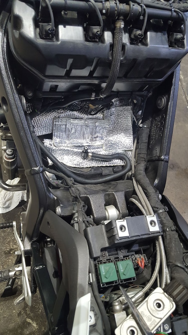

I'm having the same issues reported here and I went ahead and added the heat shielding, the same as shown in the pictures below.  But I still have the same issue: unable to restart my 2018 S1000XR after letting it sit for a few minutes (after at least a 20 minute ride).
The symptoms are somewhat similar: the dash/lights come up normally, but when I turn the key: the starter turns over (a little) then stops.  I hit the kill switch and turn the ignition off and try again.  It takes about 5 tries and then it finally starts.
I tested the battery and it reads normally for voltage - 13V immediately after turning the ignition off.  I did see that the voltage dropped to 9V momentarily when I start the motorcycle, but it does start up (this is after the bike cools down).
Below are the codes from my GS911 Autoscan.  Does anyone have any ideas what I should try next?  I'm about to purchase a battery but thought I'd run it by you all before I went down that route.

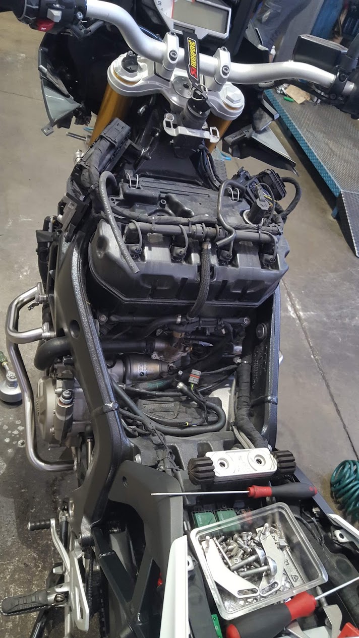

*Originally Posted by mgbiker [+]
Yeap...that is the problem according the dealer here in Athens and the the BMW Motorrad instructions...
Till now..everything ok!
Before:
After:
This doesnt transfer the high temperature from the cooland line to the fuel line..and the fuel pump works now !
