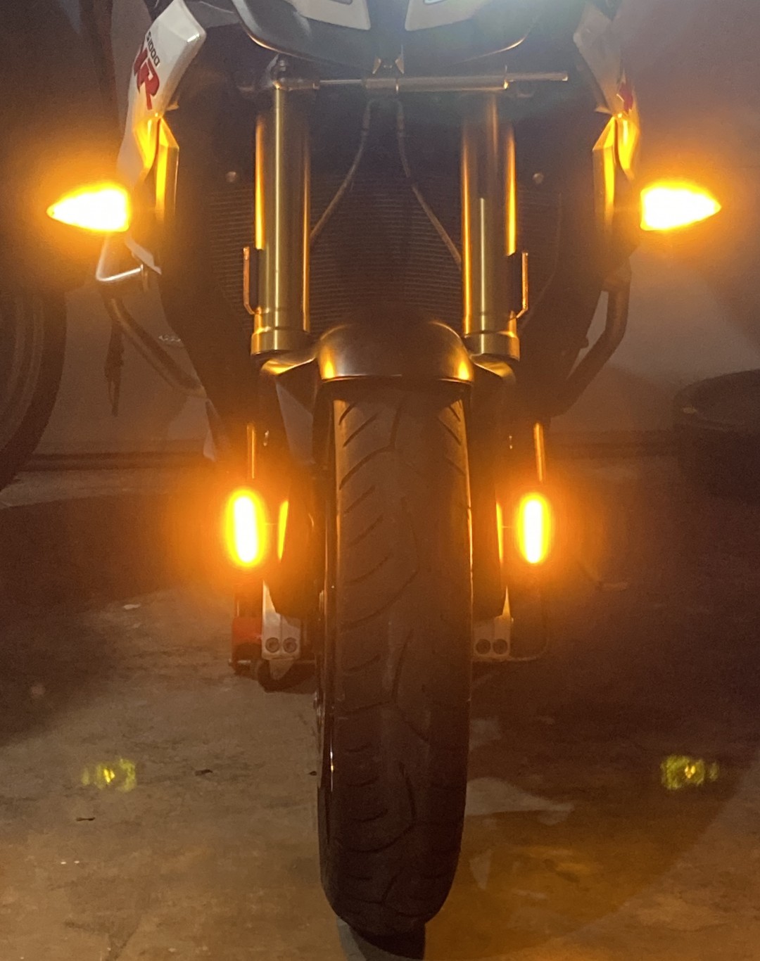

As for why BMW bikes in the US are not allowed to use the European LED turn signals, it's because they are too small. The federal requirements for turn signal size on motorcycles reads as follows:
From CFR FMVSS 108:
S5.1.1.25Each turn signal lamp on a motorcycle shall have an effective projected luminous lens area of not less than 2258 square mm. (3 1/2 square inches).
Standard 108, which deals with lamps installed by the manufacturer, is updated only occasionally and this clause no doubt dates back to the time in the past when only incandescent bulbs were available and their relatively low light output required a larger lamp area.
BMW appears not to have been aware of this requirement when they introduced their bikes to the US market with the European-legal LED signals a few years ago. These were much too small to pass and they had to recall every one and replace them with larger incandescent signals.
Fortunately, supplemental LED lamps that act as turn signals are available as are LED bulbs that can be retrofitted inside the larger housing for incandescent lamps. I have both on my bike, configured to also operate as amber DRL's and they make it much more visible to oncoming traffic - see photo.
