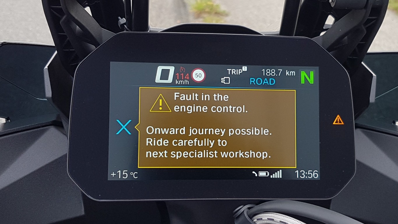

    So this issue started after I had the run-in service:  the bike goes into "emergency mode" with "limited" throttle response (actually pretty much no throttle response) and becomes un-rideable. Turning the bike all the way off and then on again will clear the fault for a while, but it will occur again.  According to the BMW diagnostic tool, the error is with the throttle limits sensor however testing hasn't found any apparent issues with either the software or any of the modules.
    The Service Manager, mechanic and myself have not been able to determine how to re-create the fault consistently, however there do seem to be at least a couple variables that seem necessary: the clutch is engaged, the engine is warmed up (cooling fans engaged) and always in gear (1st or 2nd).
    The picture is the general fault warning that the bike has gone into emergency mode. Bike was in gear when fault occurred but had to put it in neutral to take the picture!
    Anyone have any ideas?  Has anyone else experienced this problem?

    That's the first thing they checked but doesn't seem to be a power issue. At least nothing that shows up in the data.  I've had 2 false starts so far  :110:  First they thought it was loose battery cables and second time they thought it was the hillstart assist pro (manual setting conflict).  Now they are going to try swapping the clutch module and see if that fixes it but if not then they are stumped.  Whatever it is, it only causes the fault some of the time so it's very hard to pin down exactly where the problem is.
