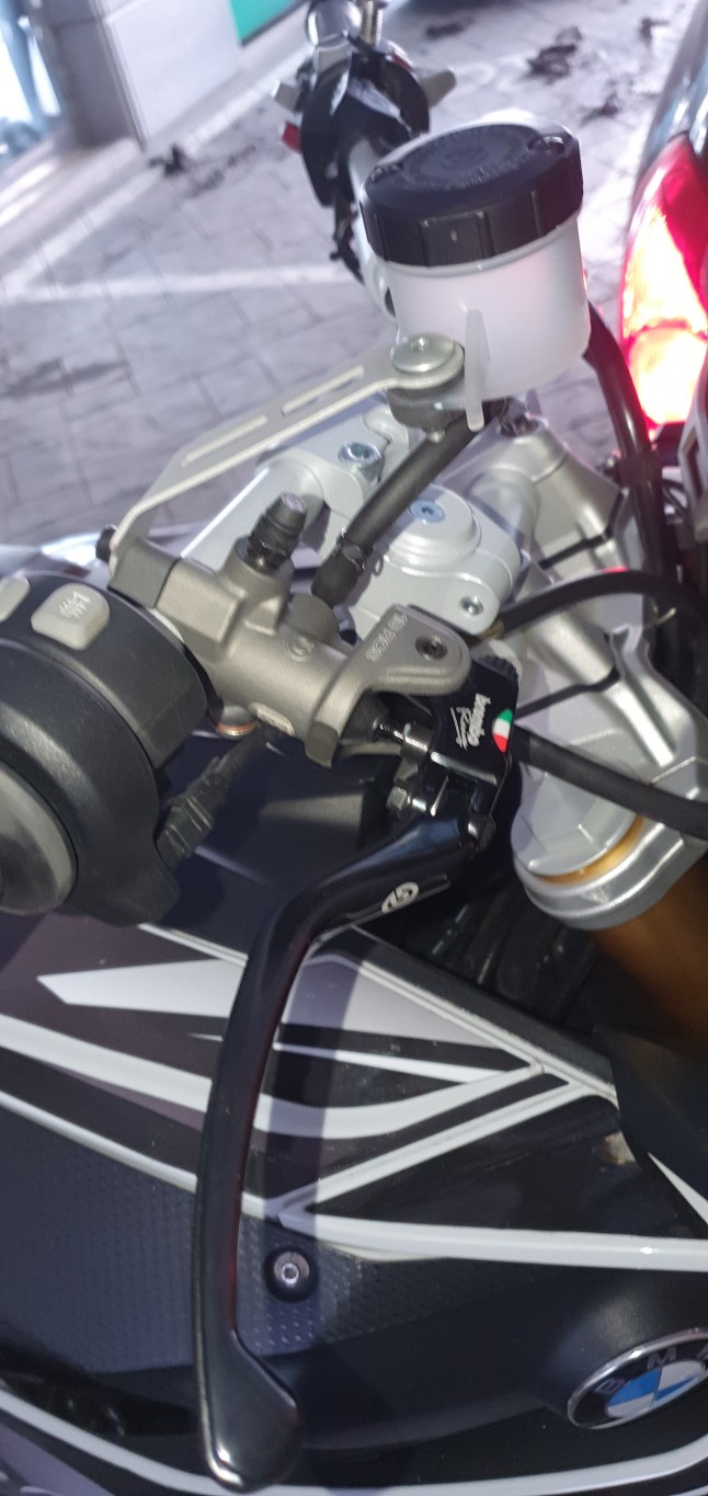

I finally got some decent winter weather to try out the Rsc19 MC. I can definitely feel improved initial hit of brakes.
ABS enabled you can feel the system max out under heavy brakes. After initial harder hit the improvement is good but not massive.  The lever feels good and give you good feedback.
With ABS disabled this makes big difference IMO over stock MC. You can really feel rotors working and can hear it. Sounds actually changed with more bite. I think now full floaters would be helpful. (hoping for forged or carbon wheels next year) I couldn't really push harder due to weather still a little cool.
Overall I think for aggressive street riding it may not be worth the price riding with ABS enabled. Track with ABS off will make them worth the price.
For installation i had helibars already ordered as i wanted to have adjustable bars to match my tall size. I moved position inward around 25mm per side and up. Luckily the stock cable was able to make it. In down position or stock bars the cable would be way to short.
