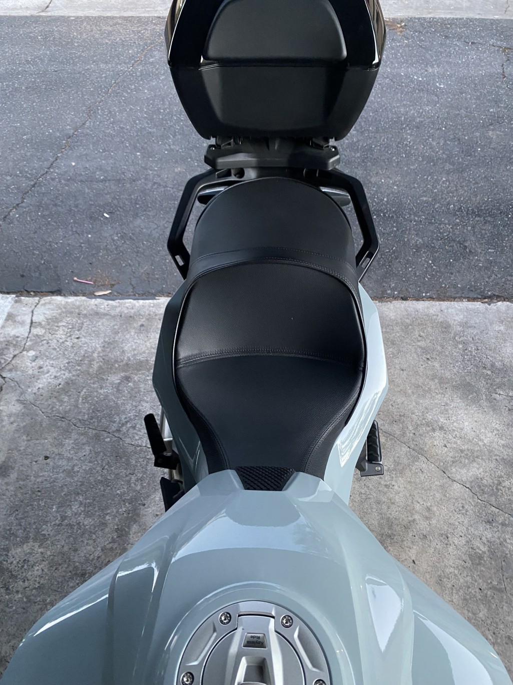

    Sargent REVolution Sea with DTX
    This was the first seat I tried to replace the stock seat.  You have to send your stock seat to Sargent and they will drop in their own padding and seat cover.  They quote a 48 hour turn around time (true for me).  They allow you to do a couple hundred mile test ride, if you don't like it, they'll provide a label to ship the seat back (you may have to pay like $20, I forget) and put the stock padding and cover on while giving you a full refund.  You have many different options with this seat in terms of stiching, welt, trims, trim colors, and even rider and passenger heated seat with remote options.  The biggest thing you must do is make sure this seat has their DTX cover!  This is their version of a grippy seat.  The DTX is no way over grippy, but it does the job.  If you don't choose the DTX, the seat will come with their CarbonFX (CFX) cover, which has zero grip whatsoever and you will slide around all day making the bike unrideable again.  This seat is a big improvement over the stock seat for me, no being pushed into the tank at all.  With this seat though, my hips are ever so slightly rotated forward.  So when your butt skips across the seat, it catches your butt and holds onto a small part of it.  I  think is partly due to the cushioning as well.  The sargent seat is not soft or overly firm, but it is more on the firm side.  However where they cut the channel in their seat (what they're known for), I think it gives a little room for the seat to slightly cave which is why a part of your butt gets caught here.
    Price: Out the door - $449.90
    Cushioning: I had no issues with the comfort of this seat regarding padding
    Seat Height: Sargent's Website says they're very careful to not alter the seat height, I couldn't feel any noticeable difference.
    Seat to Peg: I had no issues with comfort regarding the seat to peg distance.  Knees and ankles were fine.
    Sport Riding: Seat is very easy to move around on, no issues here.

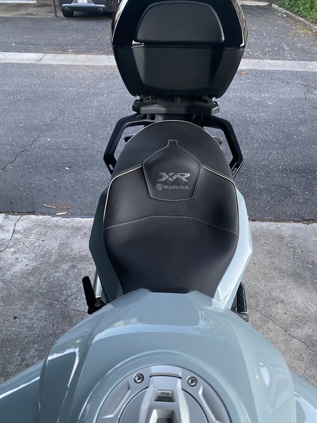

    Wunderlich AKTIVKOMFORT Seat
    This is the second seat I tried after my stock seat.  I live in United States and placed my order for this on September 8th, 2021.  I received this on December 13th, 2021.  The long lead time was the seat had to be made, and was shipping via ocean from Germany, combine that with the supply chain crunch = longer lead time.  The United State store may have them in stock now, you will have to check their website.  You can do a couple hundred mile test ride, and if you don't like it, they'll provide a full refund.  You will have to pay for shipping it back to their store, I assume they provide a cheap shipping label option.  This seat has two options, standard and tall.  The site states the standard is 5mm lower than OEM seat height, the tall is 40mm higher than OEM seat height, I went with the standard.  The earlier versions of this seat had seat pans sourced directly from BMW, now they source them directly from BMW's supplier.  So, no fitment issues whatsoever.  I did a back to back ride to compare this seat to the Sargent Seat.  100 mile loop on the Sargent, ate a quick lunch at home, and then the exact same 100 mile loop on the Wunderlich.  As soon as I sat on the Wunderlich it immediately felt better.  I could feel more support in the area where the Sargent ever so slightly caved in.  The Wunderlich does not have this slight cave in.  I don't find the Wunderlich overly firm, but it is slightly more firm than the Sargent.  I felt like I have slightly more room on this seat, and it was slightly slightly better to move around on during sporty riding.  After finishing this ride, my butt was less sore than when I completed 100 miles on the Sargent, even though I had more total miles in the saddle after completing my trip with the Wunderlich.  Probably due to a small part of your butt catching as I mentioned above, and all of the pressure being put their.  However, I wasn't in agony or anything after riding on the Sargent.
    Price: Out the door - $740.05
    Seat Height: I couldn't feel any noticeable difference from the other two seats.
    Conclusion
    The Wunderlich seat is the winner for me.  I do want to note that in my few months use with the Sargent Seat, I had gotten used to it and was fine with it.  To be honest, if I hadn't placed the order for the Wunderlich a few months ago, I don't know if I would be searching for another seat right now.  I might've stayed with the Sargent.  Fit/finish/quality is equal between the two.  Netiher of these seats lock you in and you will slightly skip across it.  This is no different than when I test rode a 2021 1250 GS or Multistrade V4, or most other bikes I assume.  I was considering trying the BMW factory lowered seat as when I sat on it, it felt comfortable when I sat on it in the showroom, and from reading online, it seems to not push you into the tank.  Again though, you'd be sitting in a bowl which would make moving around on the seat more difficult.  I'm also not sure how much lower this seat is than the stock, which could cause potential comfort issues.  Both seats do not use animals parts in their covering.  Alcantara, which is used on the Wunderlich, is a synthetic suede.  I will be sticking with the Wunerdlich Seat and selling my Sargent seat.  If you want to compare the Wunderlich seat to another one yourself, I suggest you wait until you get your Wunderlich Seat.  Then buy the other one as the Wunderlich will most likely take the longest to receive.  This way you can compare both within their refund period.
