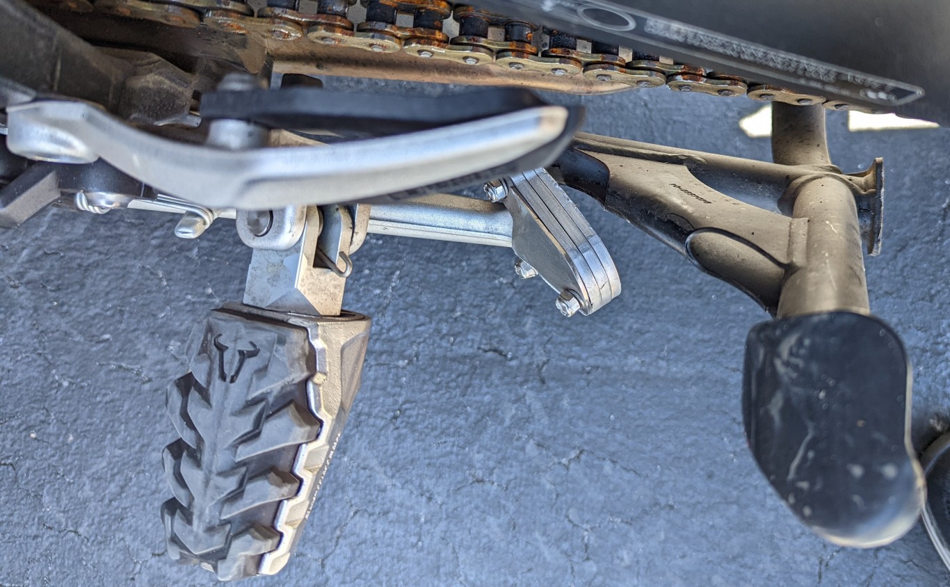

I also have a Gen2 XR and wanted a longer side stand. The only product I found that does this is Cymarc's S1000XR GEN 2 Side Stand Extension Plate at...
https://www.cymarcbikeparts.co.uk/s1000xr-gen-2-side-stand-extension-plate-1267-p.asp
Their product consists of 1 each 2mm topper, 1 each 5mm full hoop plate, 1 each 5mm non-hoop plate without beveled holes on the bottom, and 1 each 5mm non-hoop plate with beveled holes on the bottom. The two non-hoop plates will add 10mm to the length of your side stand.
If you have a center stand, that's probably the best you can do because a side stand with additional non-hoop plates will hit the center stand rather than folding into it's fully retracted position. I say probably because one additional non-hoop plate might work. See pic below; this is without any additional plates.
If you don't have a center stand, and never will, then you can keep adding non-hoop plates and longer bolts until your side stand is the length you want. Cymarc will sell you additional plates (contact mick@cymarc.co.uk), just make sure you get the non-hoop plates without beveled holes, buy appropriately longer bolts, and simply add the additional plates between the other two plate types.
Hope this helps.

I'd have given the chain a quick wipe with oil before taking that photo
