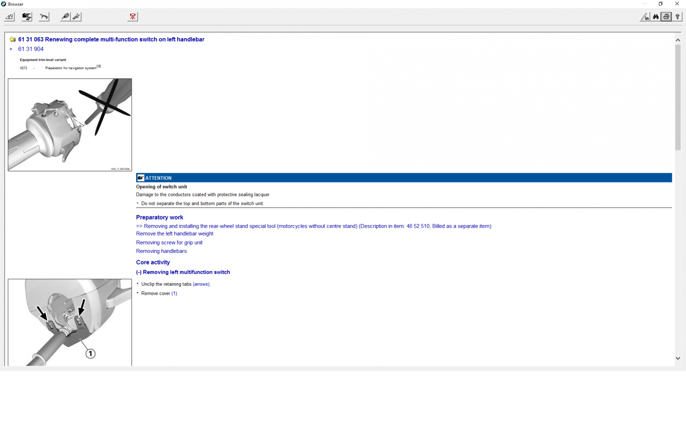

    I would advise checking the manual before dismantling the switch gear.  I'm sure my Gen 1 manual says don't!!
    Yes it does:
    Last Edit: September 10, 2023, 04:48:26 pm by JTL
