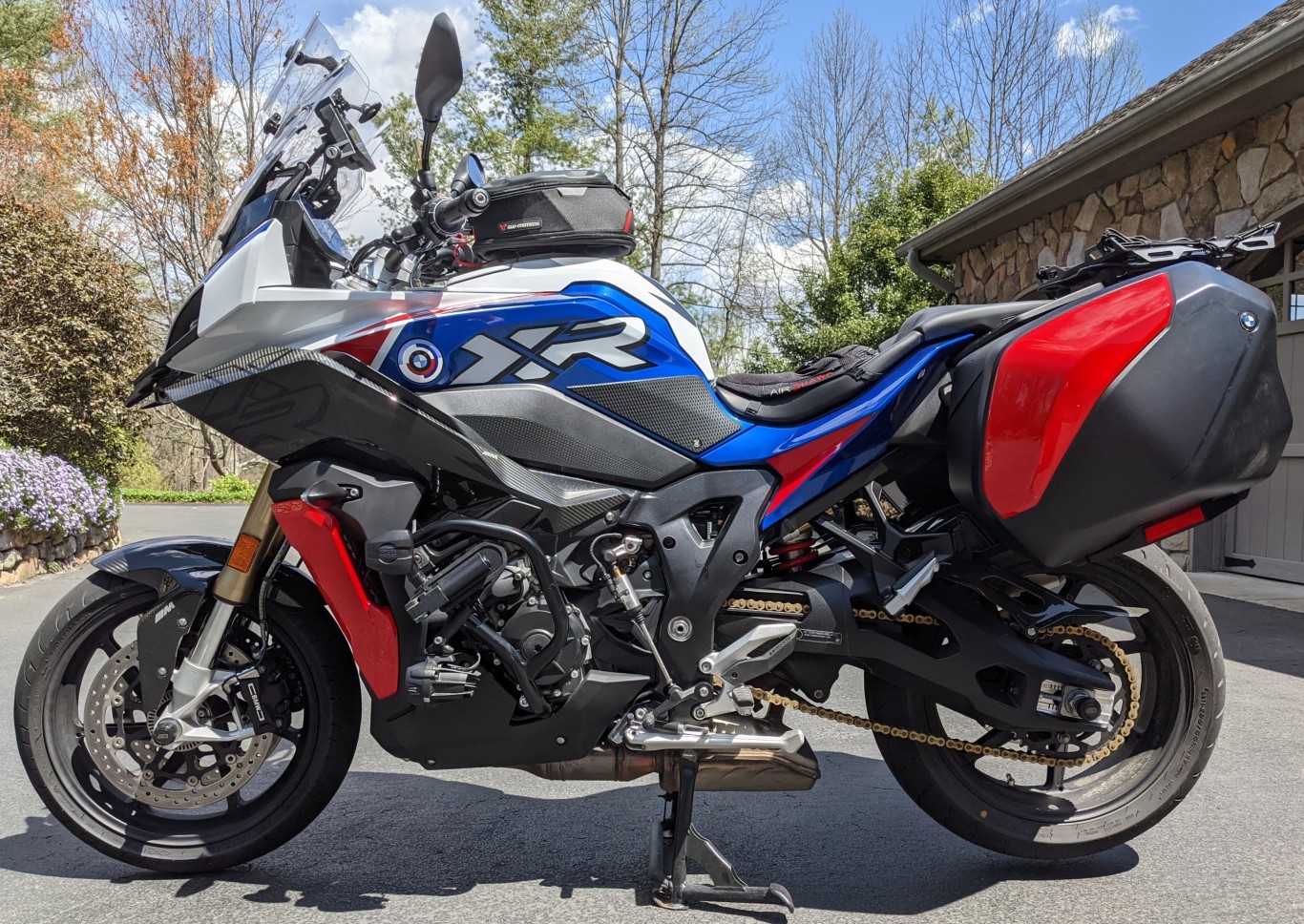

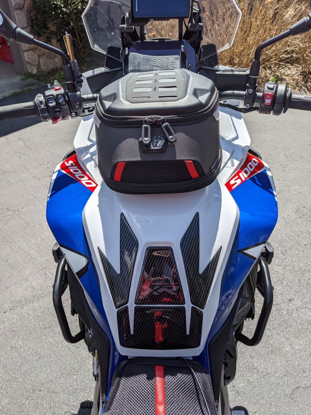

« Last post by JerryG on Today at 02:23:40 AM »
Welcome!
Tank bag recommendation: SW-Motech Pro Daypack Tank Bag. The Pro version just came out last fall. Unlike previous versions, the bag can be adjusted forward and backward as needed by loosening four bolts on the underside, sliding the upper ring forward or back, and retightening the four bolts. With this adjustability, I can easily move it back and forth between my RR and my XR. See pics.
Grip Pads and Tank Protection: I've had both Stomp Grips and TechSpec; I prefer TechSpec. The XR Techspec set came with a matching tank pad that I didn't use; instead, I used a faux carbon fiber tank protector that covered more area and looked good with my CF components. See pics.
M Chain: I have 9130 miles (14,700 km) on my M Chain so I'm still thousands of miles from knowing how this chain will ultimately perform (my RR regular chain lasted until 18,000 miles (29,000 km)). I have noticed that after three tire changes, the mark I use for setting the M Chain's tension has not moved at all, i.e., the chain length has not increased at all so far. Be aware that the owner's manual has a different take than the PR release, it says: "The low-maintenance drive chain is cleaned and lubricated in the course of the annual service interval. In the interest of an optimum service life, the low-maintenance chain can be additionally relubricated using a chain lubricant suitable for low-maintenance chains." Given this, I still apply a light coating of dry Teflon chain lub after every full day of riding.
Pics:
